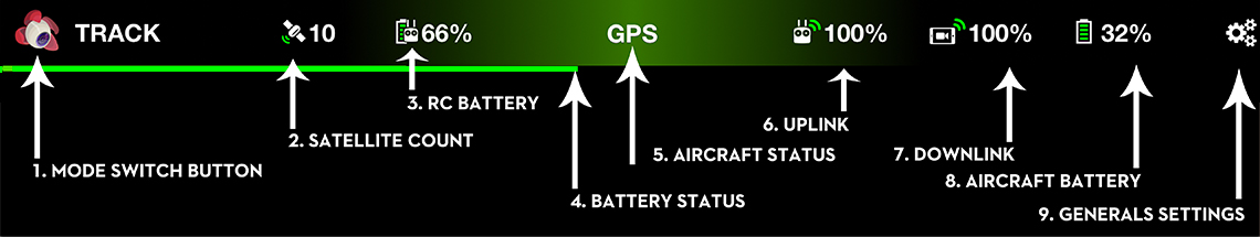

Status Bar
Responsive image
  1. Mode Switch Button: Tap to change the flight mode or to log in to your Litchi account.
  2. Satellite Count: Shows the number of satellites that the aircraft is locked onto.
  3. RC Battery/Virtual Joysticks: Shows the remaining remote controller battery percentage. When connected to a drone without remote controller, tap to show/hide the virtual on-screen joysticks.
  4. Battery Status: This bar shows the status of the aircraft battery. The part in red represents the battery required to go home.
  5. Aircraft Status: Shows the current aircraft flight status.
  6. Uplink: Shows the strength of the remote controller uplink signal.
  7. Downlink: Shows the strength of the video downlink signal.
  8. Aircraft Battery: Shows the remaining aircraft battery percentage.
  9. General Settings: Tap to show general settings.

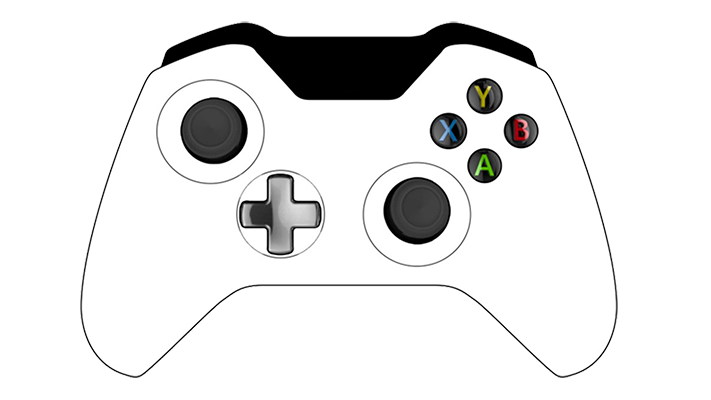

Bluetooth Controllers
Litchi allows you to control Wi-Fi based drones (Spark, Phantom 3 Standard, Mavic Air/Pro) with a bluetooth controller when no DJI remote controller is connected.
If you are looking for a compatible bluetooth controller, we recommend the Mad Catz CTRL i for iOS.
Litchi will automatically recognize and accept input from a bluetooth controller after it is paired with your mobile device.
Responsive image
  1. Left and Right Joysticks: Used to control the drone the same way you would control a drone with a DJI remote controller in mode 2.
  2. A: Take a photo.
  3. X: Start/Stop recording.
  4. B: Triggers the custom function bound to C1.
  5. Y: Triggers the custom function bound to C2.
  6. Directional Pad - Y axis: Moves the gimbal up/down.

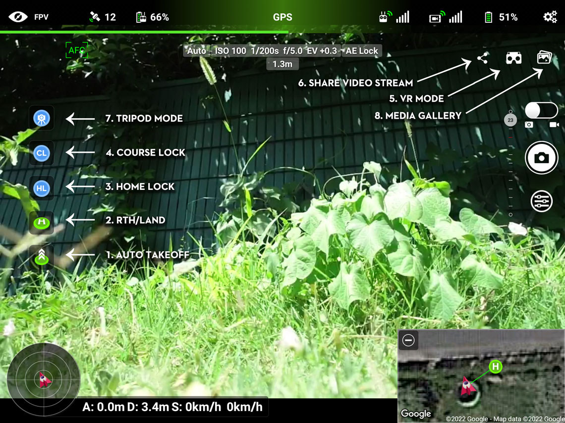

FPV
The FPV mode allows you to fly the aircraft manually using the joysticks.
Responsive image
  1. Auto TakeOff/Land: Use this to perform an automatic take off, Return to Home or landing. For take off, the aircraft will rise to 1.2m and hover.
  2. Home Lock: When enabled, moving the right joystick down (mode 2) will bring the aircraft back to the home point regardless of its current heading.
  3. Course Lock: When enabled, moving the right joystick up/down (mode 2) will move the aircraft forward/backward in the direction defined by its heading at the time Course Lock was enabled.
  4. VR Mode: Enter VR mode using this button.
  5. Share Video Stream: Tap to share your video stream. On Android and iOS, you can share it to Facebook Live (requires internet connection). On iOS you can also share the video stream to a nearby Litchi Vue app.
  6. Tripod Mode: Enable/disable Tripod mode. In Tripod mode, the maximum speed is limited to 2.2mph (3.6kph). Responsiveness to joystick movements is also reduced for smoother and more controlled movements. Tripod mode is only supported by the following drone models (Phantom 4 Advanced/Pro/ProV2, Inspire 2, Spark, Mavic Air/Pro, Mavic 2 Zoom/Pro). For Mavic 2 Zoom/Pro, enable Tripod mode using the RC mode switch.

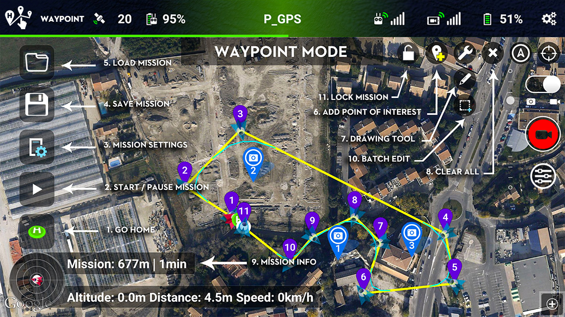

Ground Station / Waypoints
Litchi's Ground Station mode allows you to setup waypoint missions.
Place multiple waypoints on a map however far you want and the aircraft will fly from waypoint to waypoint and complete the mission even if the signal is lost.
On Android, to enter the Ground Station, press the Flight Mode icon at the top left of the Litchi screen. Select "GS". You can then start editing missions.
Responsive image
  1. Go Home: Tap to trigger Return to Home.
  2. Start/Pause/Resume Mission: In edit mode, tap this button to show the pre-flight report and then start the mission. While in a mission, this button will allow you to pause and resume the waypoint mission.
  3. Save Mission: Tap this button to save a mission.
  4. Load Mission: Tap this button to load a previously saved mission.
  5. Drawing Tool: Toggles the drawing tool. When on, you will be able to draw a path of waypoints on the map.
  6. Clear All: Tap to reset everything in the editor.
  7. Mission Info: Shows general mission information. In edit mode, the total distance and time will be shown. During a mission, the "target" waypoint number will be shown.
Waypoints
To add a waypoint, tap anywhere on the map. You can add up to 15 waypoints.

Enter the Waypoint mode by pressing the Flight Mode icon at the top left of the Litchi screen. Select "Waypoint". You can then start editing missions.
Responsive image
  1. Go Home: Tap to trigger Return to Home (Android only). Return to Home can also be triggered using the remote controller.
  3. Mission Settings: Tap this button to display the mission settings.
  4. Save Mission: Tap this button to save a mission.
  5. Load Mission: Tap this button to load a previously saved mission.
  6. Add Point of Interest: Toggles the Point of Interest mode. When on, a click on the map will add a Point of Interest.
  7. Drawing Tool: Toggles the drawing tool. When on, you will be able to draw a path of waypoints on the map.
  8. Clear All: Tap to reset everything in the editor.
  9. Mission Info: Shows general mission information. In edit mode, the total distance and time will be shown. During a mission, the "target" waypoint number will be shown, as well as the current state of the aircraft.
  10. Batch Edit: Tap to enter Batch Edit mode. Allows you to easily edit multiple waypoints at once.
  11. Lock Mission: Tap to lock/unlock the mission for editing. A mission's waypoints cannot be edited until the mission is unlocked. By default, missions are locked after they are loaded.

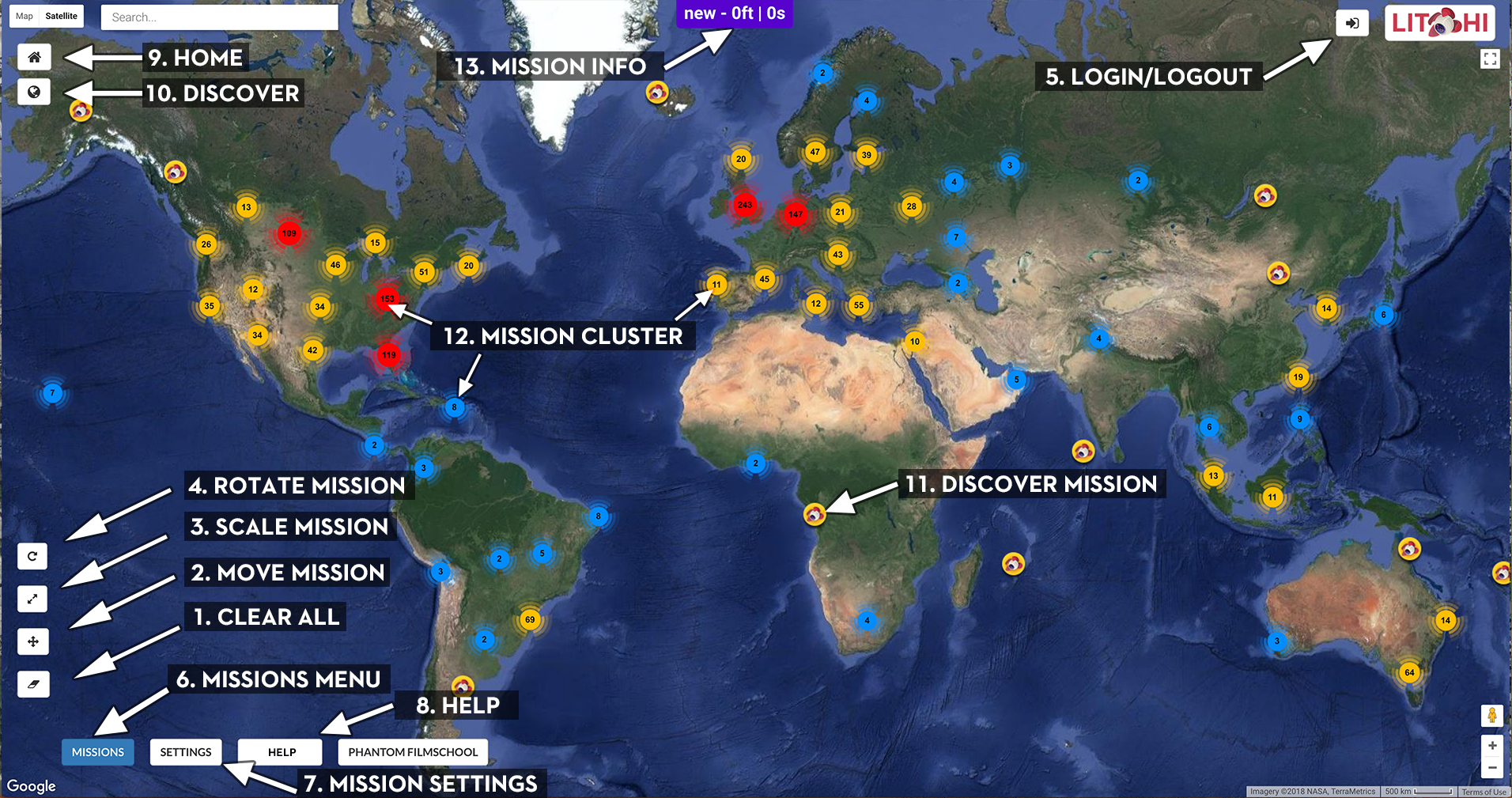

Mission Hub lets you plan waypoint missions from a desktop or laptop PC/Mac.
If you are logged in to your Litchi account, saving a mission will automatically synchronize it across all devices where you are also logged in.
In addition, Mission Hub lets you browse missions from other users around the world or publish your own missions and videos for other users to see.
Info For the best experience, we recommend using the Google Chrome browser to access Mission Hub.
Responsive image
  1. Clear All: Removes all waypoints and points of interest.
  2. Move Mission: Click to enable the move tool. Once enabled, you can move the entire mission by dragging any waypoint. Additionally, you can click anywhere on the map to move the mission to that location.
  3. Scale Mission: Click to enable the scaling tool. Once enabled, you can scale the entire mission by clicking on a waypoint, holding the click and moving the mouse.
  4. Rotate Mission: Click to enable to rotate tool. Once enabled, you can click anywhere on the map to place the rotation's center. Then, click on any waypoint, hold the click and rotate around the center to rotate the entire mission.
  5. Login/Logout: Click to login to or logout of your Litchi account. Once logged in, saved missions will automatically synchronize across all devices where you are also logged in.
  6. Missions Menu: Hover to show the main menu, described in the 'Missions Menu' section below.
  7. Mission Settings: Click to open the mission settings. These settings are similar to the ones you will find in the mobile Litchi mission planner, please refer to the Waypoint tab to learn more about each setting.
  8. Help: Click to show useful shortcuts as well as a link to this help page.
  9. Home: Click to zoom the map to your current location. If the laptop/desktop PC/Mac you use has no GPS sensor, your router will be used to determine your location and it may not be very accurate.
  10. Discover: Click to fully zoom the map out. This allows quick access to missions around the world.
  11. Discover Mission: Missions from other users which are public and have a video attached to them are shown on the map with a Litchi icon on yellow background. Click on it to load the mission. Double-click on it to watch the attached video.
  12. Mission Cluster: Mission clusters represent multiple missions in one location, click on it to zoom in closer at that location and see all missions within that cluster.
  13. Mission Info: Shows the mission's name ('new' when no name) as well as the total distance of the mission and the estimated time it will take to complete.
Missions Menu
  • New: Click to create a new mission.
  • Open...: Click to open the mission browser. In the mission browser's 'My Missions' tab, you can open your own missions and view/edit them. Attaching a video to a mission and disabling the 'Private' checkbox will make it appear on the map for other users. The mission browser's 'Discover' tab lists public missions from other Litchi users.
  • Save...: Click to save the current mission. At least 2 waypoints required.
  • Import...: Click to import a mission into Mission Hub. Supported file formats are CSV, KML and Litchi Mission files.
  • Export as CSV: Click to export the current mission as a CSV file.
  • Export as KML 3D Path: Click to export the current mission as a KML file. This can then be imported in Google Earth Pro to view the planned mission in 3D.

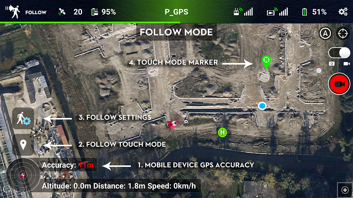

Responsive image
  1. Mobile Device GPS Accuracy: The estimated accuracy of your mobile device's location, in meters/feet. If you draw a circle centered at your mobile device's location, and with a radius equal to the accuracy, then there is a 68% probability that the true mobile device's location is inside the circle. If this number is red, it means your current location accuracy is over the "Maximum Location Accuracy" general aircraft setting. In such a case, you will not be allowed to start Follow. If you are having difficulties getting a good location accuracy, try another area, try another mobile device, or increase the "Maximum Location Accuracy" general aircraft setting. Setting the "Maximum Location Accuracy" to a higher value will allow for a bigger margin of error for the mobile device GPS signal, but the follow me movements may be less precise.
  2. Follow Touch Mode: Tap to toggle the Follow Touch mode. In this mode, the aircraft will follow the Touch mode marker instead of the mobile device.
  3. Follow Settings: Tap to display the follow settings (more details below).
  4. Touch Mode Marker: When the Follow Touch Mode is enabled, tap anywhere on the map to set this marker, which the aircraft will follow. The marker is also draggable.

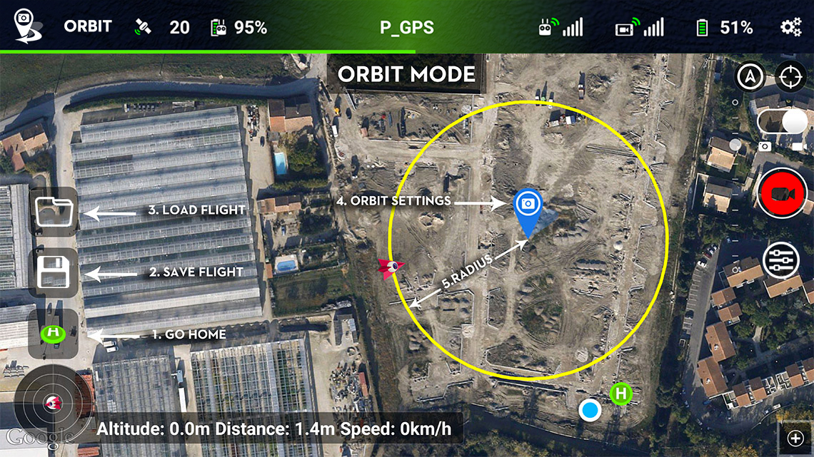

Responsive image
  1. Go Home (Android only): Tap to initiate Return to Home at any time. Return to Home can also be triggered using the remote controller.
  2. Save Flight: Tap to save the current Orbit parameters.
  3. Load Flight: Tap to load a previously saved Orbit flight.
  4. Orbit Settings: Tap the point of interest marker to bring up the Orbit settings window (details below).
  5. Radius: The orbit circle is displayed on the map with a yellow line. It is updated in real-time if you change it during an Orbit session.

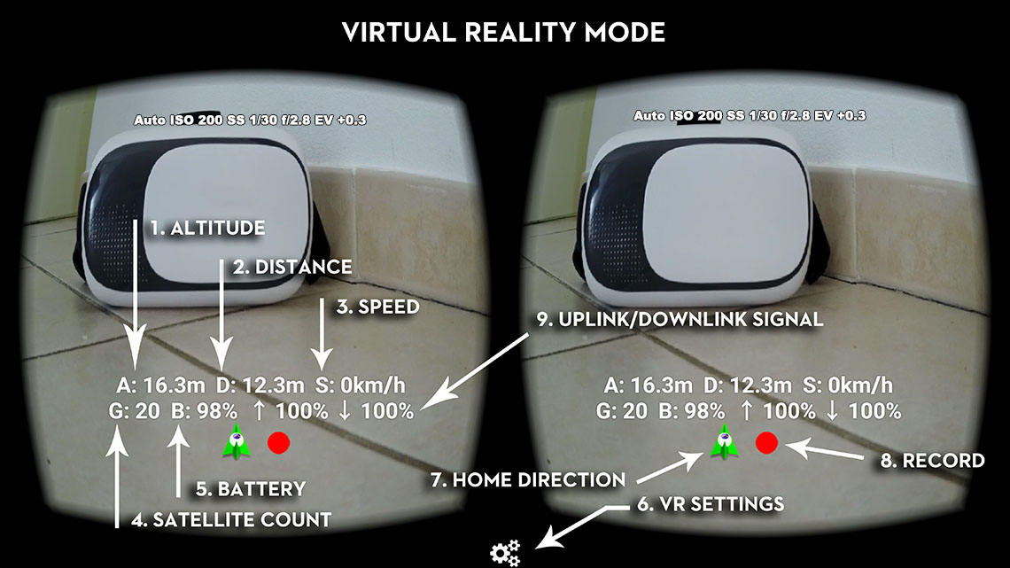

Responsive image
  1. Altitude: Displays the altitude of the aircraft relative to the elevation where it was powered on.
  2. Distance: Displays the distance from home point to aircraft. In Follow mode, displays the distance between the mobile device and the aircraft.
  3. Speed: Displays the current aircraft speed.
  4. Satellite Count: Shows the number of satellites that the aircraft is locked onto.
  5. Battery: Shows the remaining aircraft battery percentage.
  6. VR Settings: Tap to bring up the VR settings (more details below).
  7. Home Direction: Shows the heading of the aircraft relative to the home point. When this icon points towards the bottom of the screen, it means the aircraft is heading towards the home point.

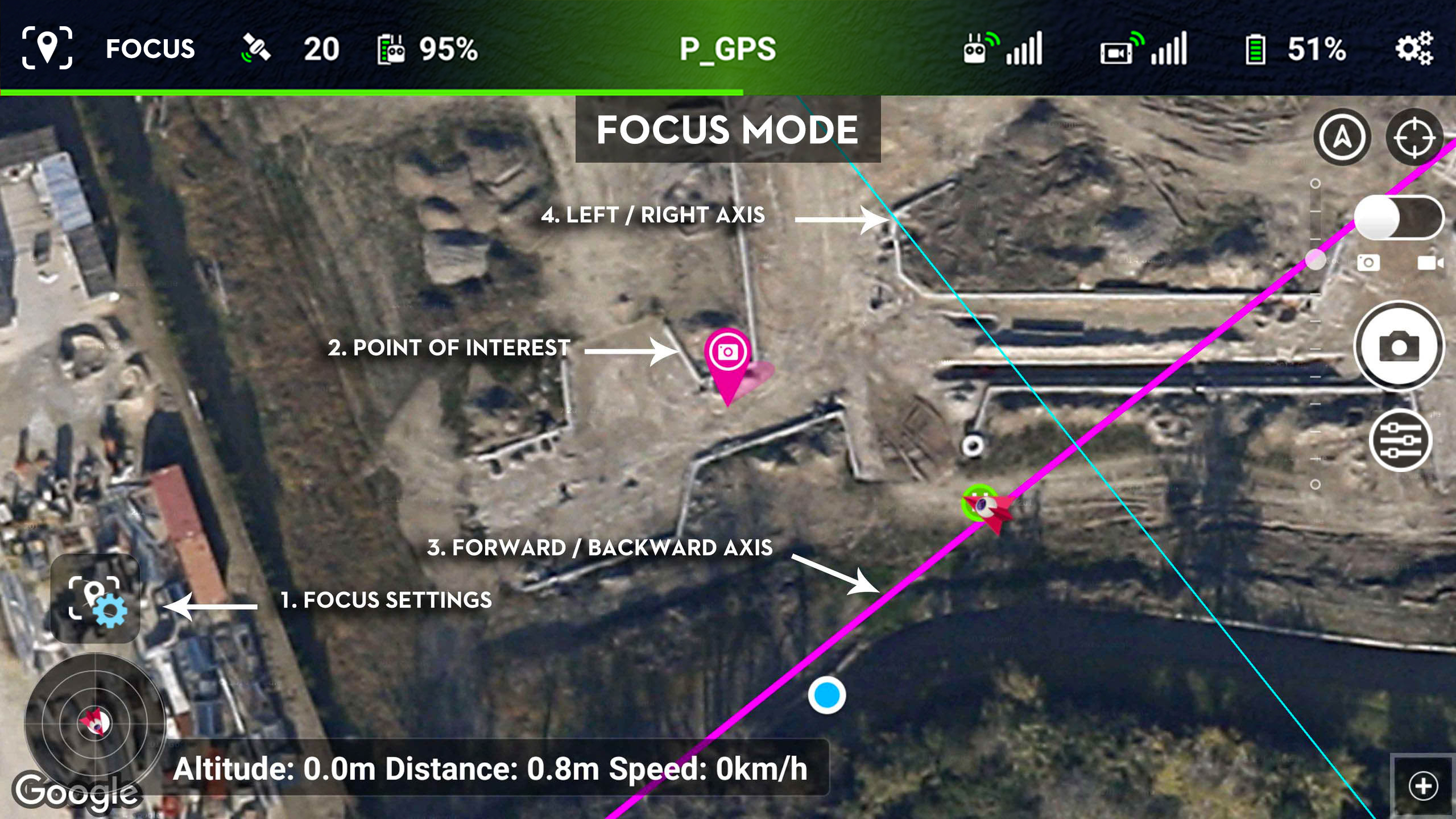

Responsive image
  1. Focus Settings: Tap to bring up the Focus settings window (details below).
  2. Point of Interest: The point of interest marker.
  3. Forward/Backward Axis: Represents the "Joystick Reference" pitch axis along which the aircraft course is locked. Shown when "Aircraft Rotation" is enabled and a custom "Joystick Reference" is selected.
  4. Left/Right Axis: Represents the "Joystick Reference" roll axis along which the aircraft course is locked. Shown when "Aircraft Rotation" is enabled and a custom "Joystick Reference" is selected.

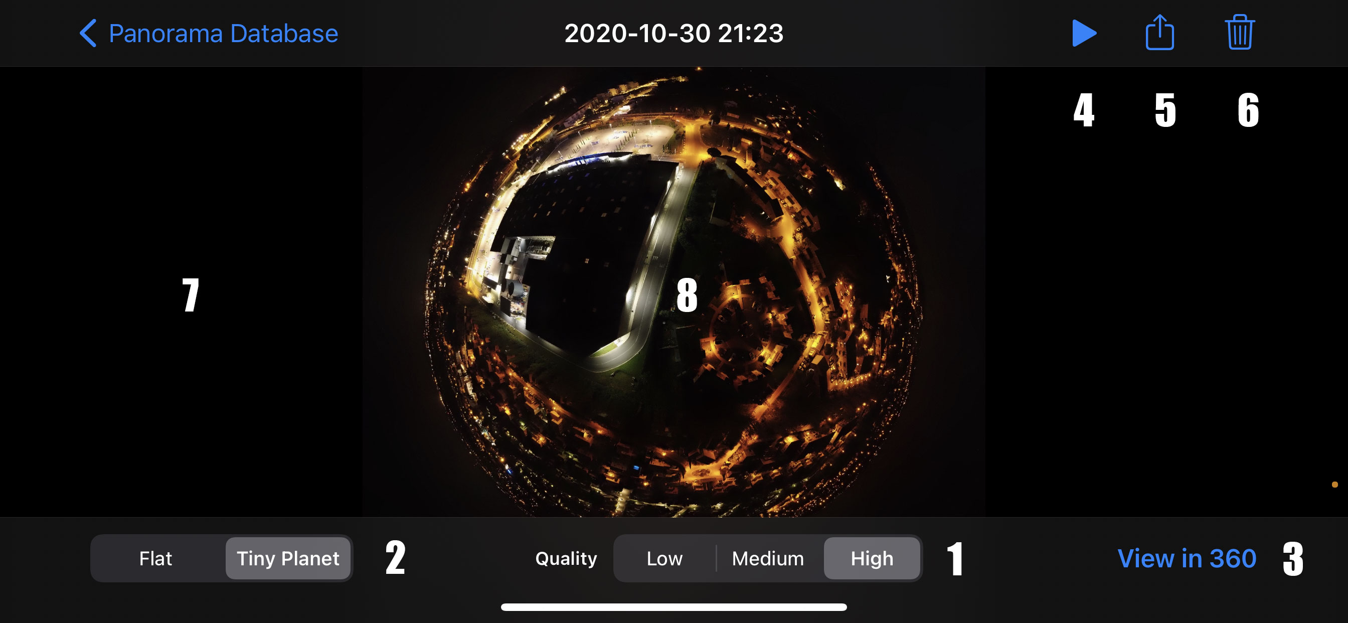

Once the panorama is stitched, you will be presented with the below interface:
Responsive image
  1. Reset: Tap to "un-stitch" the panorama, this will allow you to re-stitch it in a different quality.
  2. Toggle Tiny Planet: Tap to switch between equirectangular and tiny planet mode.
  3. View Sphere: Tap to view the panorama in 3D.
  4. Delete: Tap to delete this panorama.
  5. Share: Tap to share the panorama. In equirectangular mode, the panorama will be shared in 3D if the recipient supports it (e.g. Facebook).
  6. Export Movie: In tiny planet mode, tap to export a movie of the tiny planet rotating. After exporting it, you will be able to share it.
  7. Browse Panorama Photos: In equirectangular mode, swipe left/right to browse through the panorama's photos.
  8. Zoom/Rotate: Use the pinch to zoom gesture to zoom an image. In tiny planet mode, you can also rotate the image using circular finger motions.

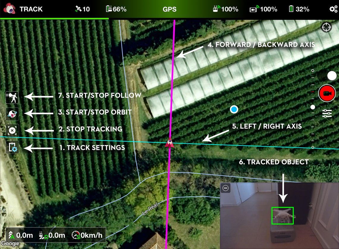

Responsive image
  1. Track Settings: Tap to bring up the Track settings window (details below).
  2. Stop Tracking: Tap to stop the current Track session.
  3. Start/Stop Orbit: Tap to start or stop an autonomous Orbit around the tracked object. The speed at which the aircraft will orbit can be changed in the Track settings.
  4. Forward/Backward Axis: Represents the "Joystick Reference" pitch axis along which the aircraft course is locked. Shown when "Aircraft Rotation" is enabled and a custom "Joystick Reference" is selected.
  5. Left/Right Axis: Represents the "Joystick Reference" roll axis along which the aircraft course is locked. Shown when "Aircraft Rotation" is enabled and a custom "Joystick Reference" is selected.
  6. Tracked Object: A green rectangle around the object means Litchi is confident it is tracking the correct target, an orange rectangle indicates less confidence, a red rectangle indicates a very low confidence.
  7. Start/Stop Follow: Tap to start or stop an autonomous Follow.
